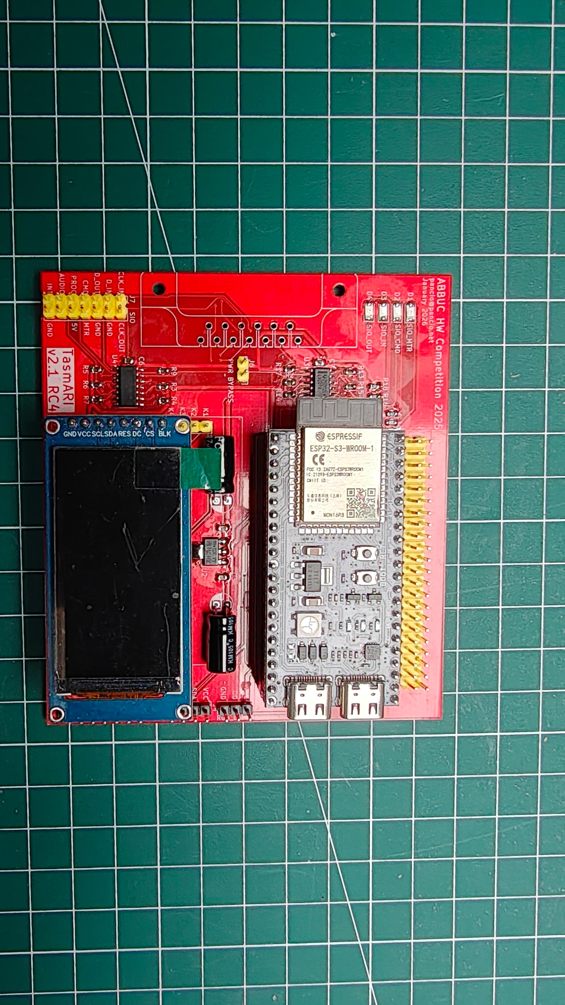

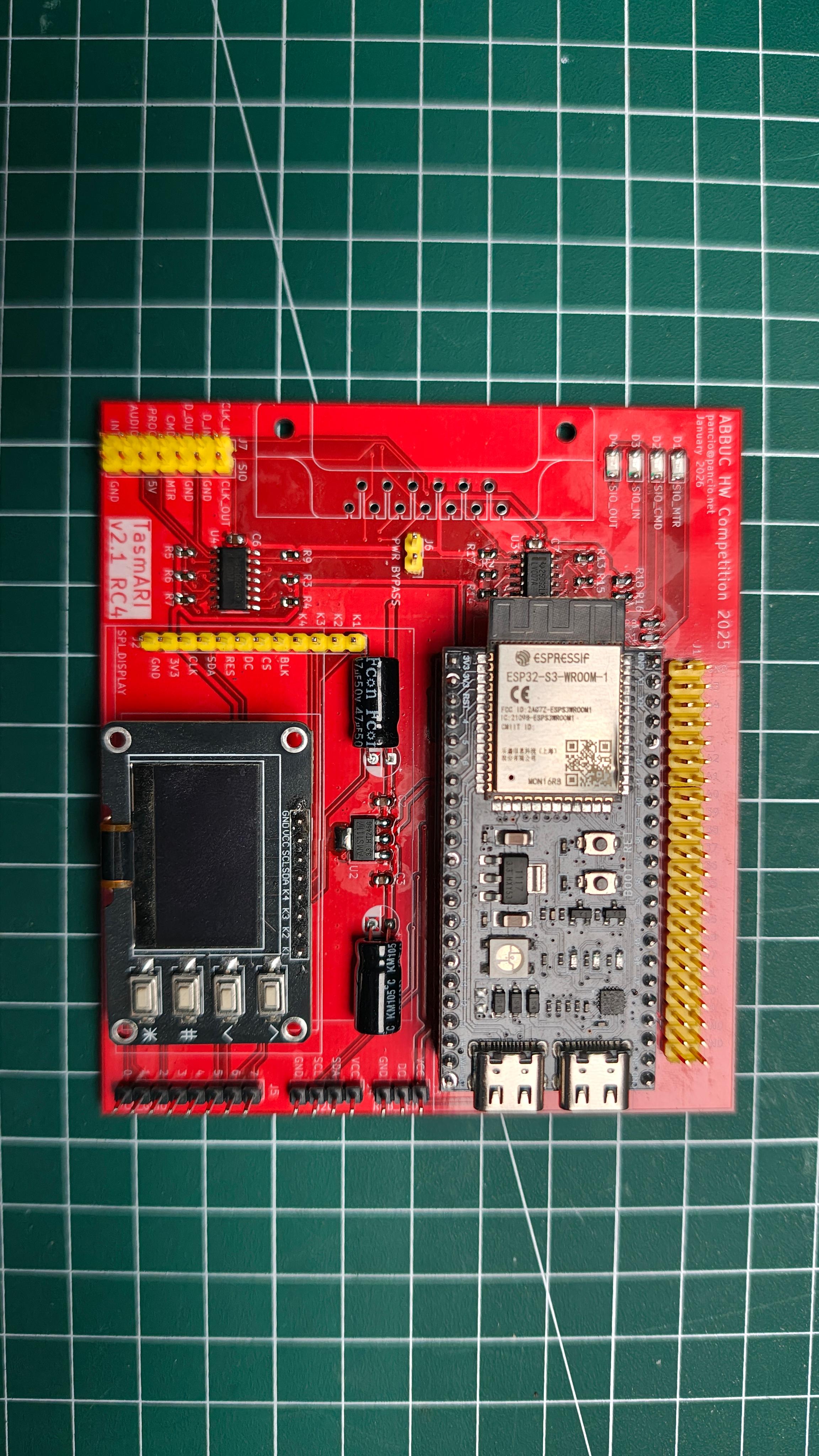

Hi Mathy,
Size is 10x9cm. I've plan to fit it to be ready fit @beetle's enclosure used for Fujinet but not with this PCB batch. OLED display is mono only but has four buttons ready to use via PCF8574 and working on I2C bus. Driver SSD1306 OLED 128x64 TFT display is full color IPS type using SPI bus. Driver ST7735 160x128pixels. Buttons on additional PINS (as above available via PCF8574)
Tasmota covering many other drivers: https://tasmota.github.io/docs/Universal-Display-Driver/#step-1-check-that-your-display-is-supported-by-udisplay-driver
Yes, Tasmota/TasmARI can work with Matter - need to be compiled with additional conditions but it's native supported.
Sorry for dirty PCB - it's before washing :-)
BR, pancio

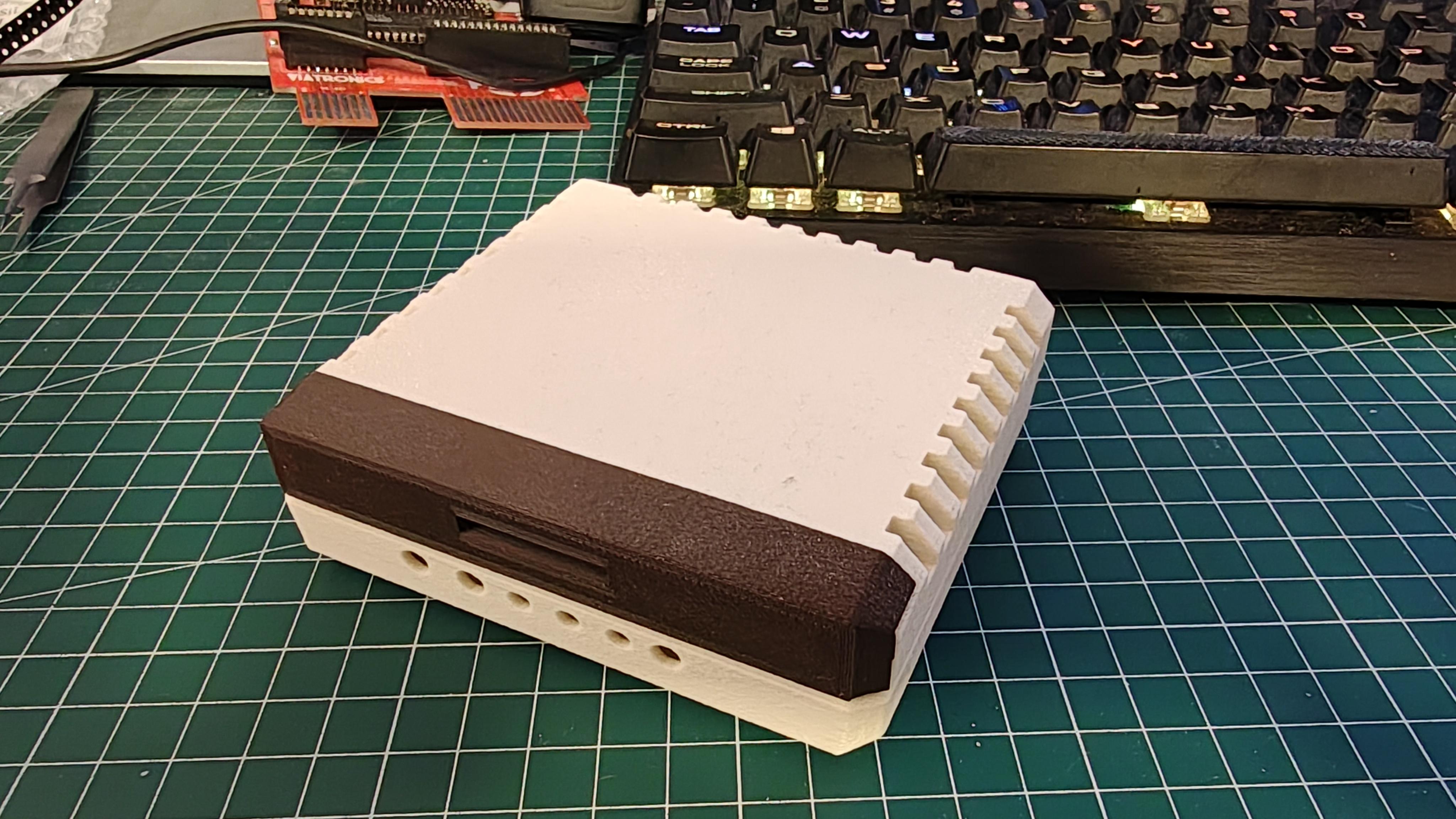

H Mathy,
I talked to @Beetle on Fujiama and he could do it, but I think it would be easier if I just redesigned the board a bit smaller. Either way is open :-)
BR, pancio

. Hello pancio
I asked Beetle for a MIDI-Mate case based on his FujiNet case. The result was a mix of his design and my ideas.
I'd prefer a similar case for the TasmARI, not a PCB that fits into something that was intended for something else.
